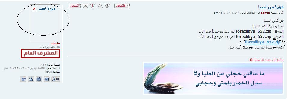

مشكلة فى صورة شخصية ورفع ملفات فى منتدى[مجابة]

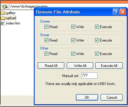

??????? ???? ??????? ? ???? ?? ????? ???? upload ??????? ??? avatars ???? ????? ???? ?? Images ?????? ??????? (???? ?????? 777 ?? ??ftp ???????? chmod ?? ????) ? ????? ?? ??? ?? ??? ??????? ...gkaled2004 كتب:??????? ?????? ??? ???? ?????? ?? ????? ??? ?? ???? ?? ???? ??? ??? ??? ???? ??????

????? ? ?????? ????? ???? ????? ?????? ??????? ??? ?????? ???? http://www.phpbb.com/community/viewtopic.php?p=3240845

Re: Avatars not showing after upgrade
by Well Fed on Tue Oct 30, 2007 2:31 am
Well...seeing as nobody was willing to help...I finally found a solution on my own...
CHMOD these folders/files to 777 and then back to their proper setting:
/download/ - 755
/download/file.php - 644
Fixed up the avatar issue...
/download/ - 755
/avatars/ - 755
/avatars/upload - 644
/avatars/gallery- 644
